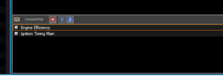

Really infuriating seemingly not being able to add to "favourites".

In options you need to turn on Enable adjust group editing.
Then you will have the settings gear appear
Adjust group editing 2.png (21.39 KiB) Viewed 19399 times
At the bottom of this screen, you can change your favourites.
Adjust group editing 3.png (15.01 KiB) Viewed 19399 times
This was covered on page 32 of the user guide that was also provided for download.

That is pretty neat, especially for those of on the Multi Throttle Body tuning method using the Inlet Manifold Pressure Estimate Main table I can never remember about!

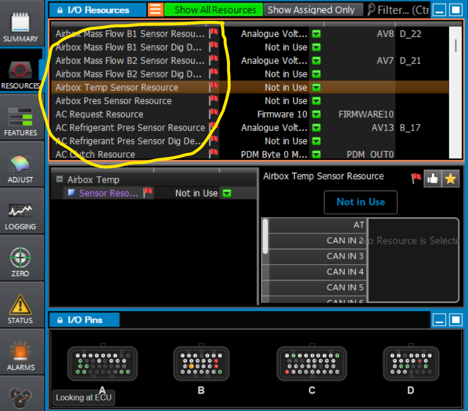

I've only just started using Motec M1 tune (1.4) and so just getting to grips with resource assigning.
Loving the new look and pin out pictorial, very handy.
Is there a way to edit the I/O resources names that you pick from or add a note so I know what they actually are?
For example I'm wanting an I/O's for an Accusump pressure sensor and solenoid but can't find anything meaningful.
I have an excel spreadsheet listing what they are but didn't want to be complicating things if there was a better way.
Thanks in advance
Thezedhed
Posts: 23
Joined: Thu Jul 11, 2024 9:26 am
Re: M1 Tune 1.5 feedback
Postby SOReilly on Fri Nov 22, 2024 8:36 am
Thezedhed wrote:I've only just started using Motec M1 tune (1.4) and so just getting to grips with resource assigning.
Thanks in advance
M1 Tune doesn't have any name aliasing. If you are logging a channel and want the name to appear differently for analysis i2 allows you to alias a channel

Postby Thezedhed on Fri Nov 22, 2024 9:03 am
Thanks for the reply SOReilly,
At least I know I'm not missing something or doing it wrong :D
