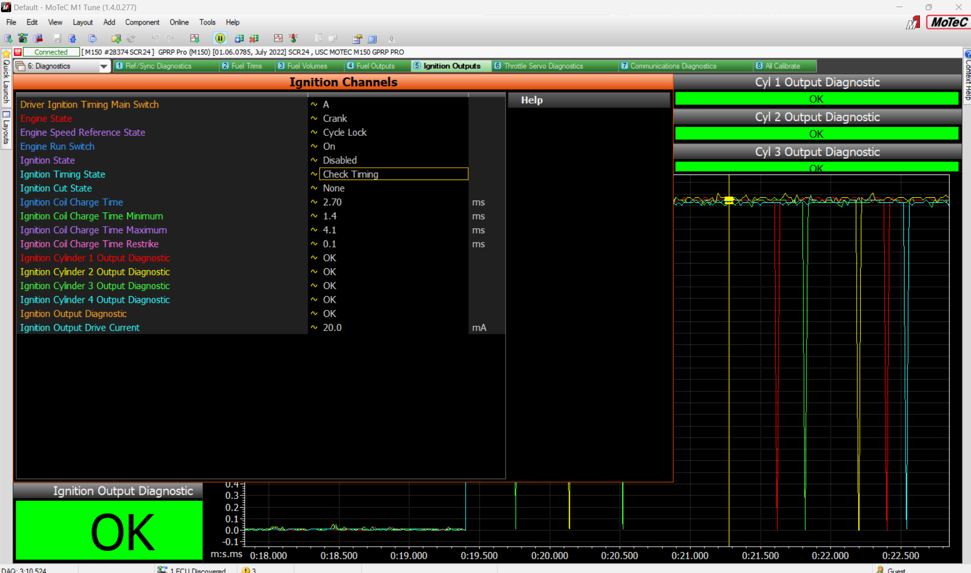

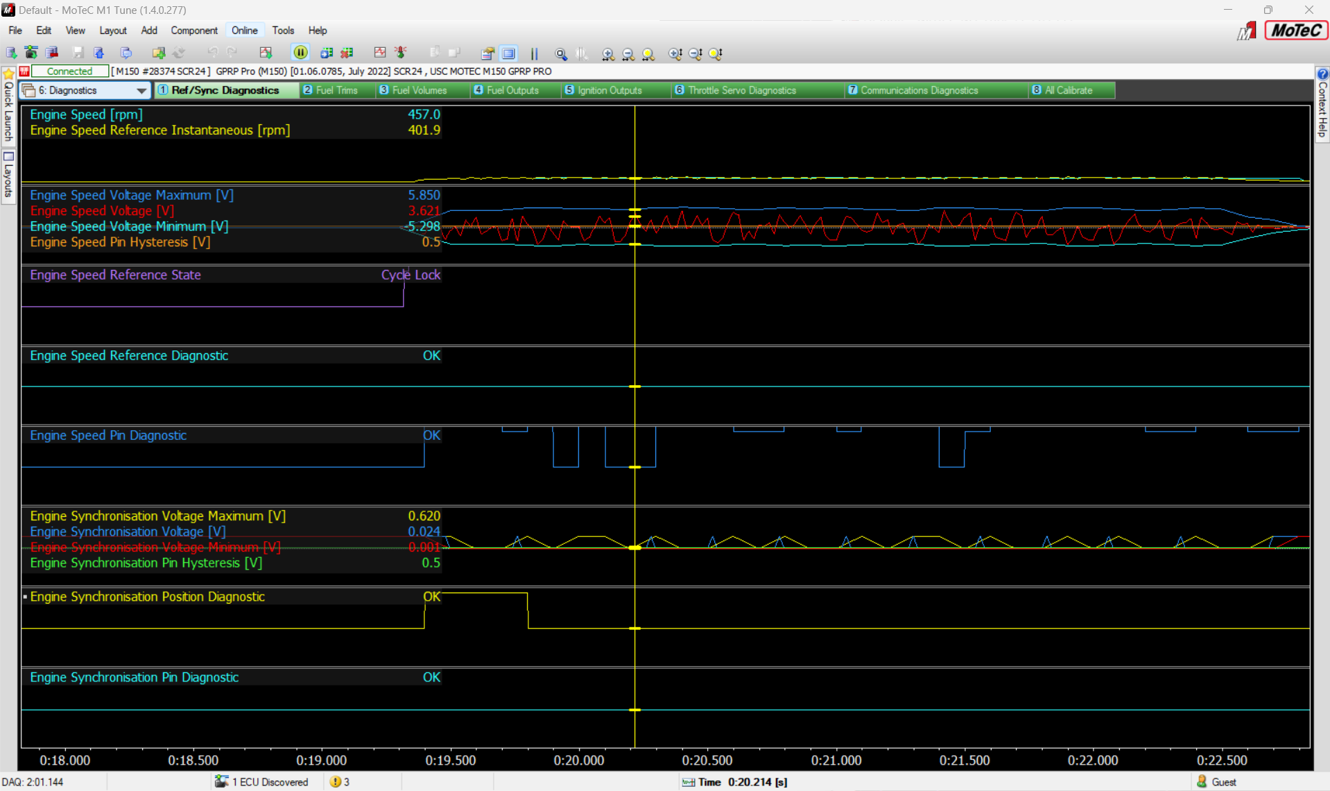

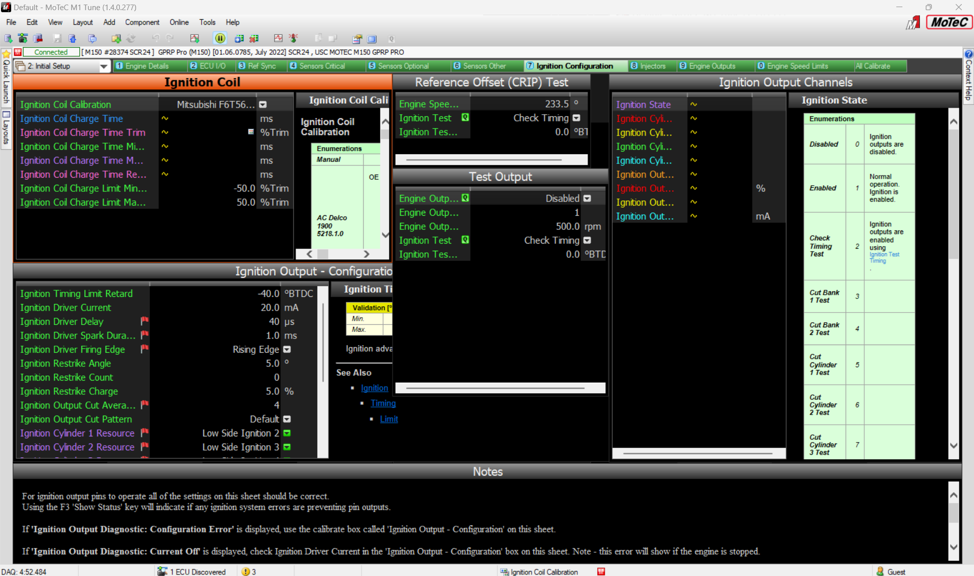

My FSAE team is using a M150 GPRP-pro package on an 06 Yamaha R6 with stock injectors and coils . We are having issues trying to start and even just trying to use the timing light to verify our reference offset is correct. We get cycle lock when cranking but the coils don't seem to be firing. We are using a Bosch coil driver and we have verified all of our wiring is correct and that we have 12V at the injectors and coils. We appear to be getting voltages for the ignition cylinder voltages but we don't get spark which we verified by physically taking out the coil with a spark plug and grounding it. When we run the timing test with the timing light we have not been getting any flashes from it. It states that ignition state is disabled even when we are cranking with check timing, when the help menu says that it should say check timing state. I don't get how we can see ignition cylinder voltages but have ignition state disabled. I have seen others have issues with the engine run switch as we do not have one as well, but I set the switch to be defaulted to on. What can we do to resolve this and get to running?

What are the errors that are being reported with the Ignition outputs and the Engine Speed Pin Diagnostic? Do you have any logging that can be shared?

Quick update to my post. I got the ignition state to be enabled now by setting my engine run switch to not in use instead of default, I also switched my configuration for ignition driver to be set to falling edge. I now get ignition state enabled when cranking but am still not getting spark. I am using a Bosch coil driver (0 227 100 211) and I've followed continuity with all my wiring to the coils and I get 12V at the coils. I am monitoring the output pin voltages when cranking and I see that they are around 3 volts. Looking at the datasheet, which I will attach to this post, it seems that the input voltage has to be greater than 6 volts which I was comparing to the motec ign 4 module that takes input voltage of 1 to 2.4V. I am wondering if this coil driver is supported by the M150 or if there is any other configuration setup I can do. Thank you for your time.

Have you tried setting the engine run switch from 'not in use' to default, saving the config (whilst connected to the ECU) and saving (this will trigger a reset)
Then give it a crank momentarily and see if the the ignition state stays disabled when cranking.
Re: M1 Tune Ignition State Disabled
Postby wparma on Fri Apr 19, 2024 5:35 am
I resolved the ignition state issue. It is disabled when it is set to default and enabled when set to not in use. However, I am still having issues with getting the coil driver to work and seeing spark.We have the exact same setup on last year's car and it still works fine with a different ecu. We directly copied over our injectors/coils harness and wired up the ecu connector side to the motec lowside pins.

If using the Bosch IGN module, then make sure the Ignition Driver Firing Edge is set to Falling Edge.

We have it set to falling edge in the ignition configuration page. Are there any diagnosis methods you can recommend or alternative configurations in the ignition setup page?

First, you should be able to cause the coils to fire (this is to verify your wiring, ignitor, charge time, etc), using Engine Output Test (select Ignition), Engine Output Cylinder, and Engine Output Test Engine Speed (try 1000 rpm). If this is not happening, connect an oscilloscope across the coil to measure the voltage, If there is no voltage differential, then it could be wiring or configuration issues.
Make sure to set Engine Output Test back to Disabled before saving a package.
